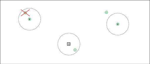

When you search identical points by position, points that lie within the tolerance are treated as identical.
When you search identical points by identifier, points that have the same point number are treated as identical.
However, points that are identical by position or by point number can have different field codes. Then, the Different Field Code dialog box is displayed. For example, two points that lie closely together and have different field codes. In the Different Field Code dialog box, you decide whether the points are identical or not. The dialog box displays identifier and field code of the two points, and provides the options as shown in the following table:
