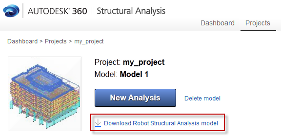

To download the structure model without results
  1. Select the model.
    The Model page opens and displays all performed analyses in your model.
  2. Click the Download Robot Structural Analysis model link.
  3. Save the RTD file.
