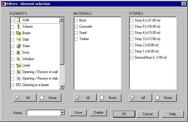

Filters - element selection by type
Using this option, you can define criteria of element selection (by element type).
Open the Filters - element selection dialog from:
Select any combination of elements, materials, and stories (the symbol displays) to specify selection criteria. For example, to select all RC beams belonging to stories 4 and 5 of a structure:
To select all options in a field, click All. To clear the selection of all options in a field, click None.
Use the options at the bottom of the dialog to save the filter settings. To save a filter, select an element selection, type its name in the Name field and click Save. You can perform the following operations for user-defined filters:
The Save option for filters is very helpful when a building is being modeled, because after you have saved the settings you do not have to redefine a specified element selection.
