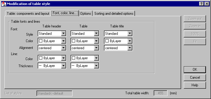

On the Font, color, line tab of the Definition/modification of a table style dialog, you can define the display parameters for a table font.
Specify font and line parameters:
- Define the style, color, and alignment of a font used in a table header, table cells, and table title (if Table with title is selected on the Options tab)
- Select the color and thickness of table lines.
