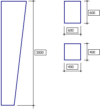

Using the Autodesk AutoCAD Structural Detailing - Formwork Drawings module, you can define and modify predefined types of prefabricated columns:
You can also define positions of the cross-section at the beginning and end of a column (how the cross-section defined at the column beginning is positioned at the column end):
Some characteristic positions of cross-sections at the beginning / end of a column |
An arbitrary position of the cross-section determined by specifying values for parameters A and B. |

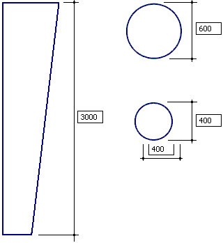

You can also define the following positions of the cross-section at the beginning and end of a column (how the cross-section defined at the column beginning is positioned at the column end):
An arbitrary position of the cross-section determined by specifying a value for parameter A. |

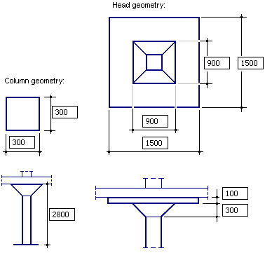

You can define the following column head types for this type of column:
