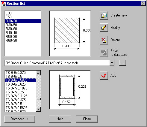

Use the Section list dialog to:
Note: As shown, the dialog is expanded to show the options in the lower part of the dialog, which are used for adding sections from a selected database. To collapse or expand the dialog, click Database.
At the top left of the dialog is a list of defined cross-sections of structure elements. These sections will be presented on the selection lists of element cross-sections. When you select a section from the list, a schematic drawing displays with characteristic section dimensions.
Use the icons in the dialog:
Create new - opens the Section definition dialog where you can define a new cross-section. The section is added to the list of available sections in the current project.
Modify - opens the Section modification dialog where you can modify parameters (such as name and dimensions) of a selected section.
Delete - removes a selected section from the list of available sections in the project.
Save to database - saves the section to an external database file.
The options on the expanded dialog:
To add a section from a database to the list of sections available in Autodesk AutoCAD Structural Detailing - Formwork Drawings, click (Add). The section will be added to the list at the top left of the dialog.
Note: All section databases used in Robot can be imported to Autodesk AutoCAD Structural Detailing - Formwork Drawings.
