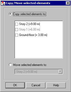

Using this option, you can copy or move selected structure elements (walls, beams, columns, slabs etc.) as well as openings in the walls and slabs (openings, windows, doors etc.) to a new location.
Open the Copy/Move selected items dialog from:
- Menu: Formwork Drawings > Tools > Copy/Move elements
- Ribbon: ASD - Model > Modify > Copy > Move elements
- Toolbar: Modify > Copy > Move elements
- Command line : RBCX_TOOL_COPYOBJECTS.
Modify the elements:
- Copy selected elements to - select a story or stories (
symbol displays) to which the selected elements should be copied
- Move selected elements to - select a story to which the selected elements should be moved.
