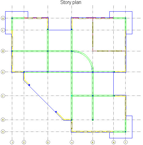

Creating of a plan (projection) of a building story
After a structure model has been edited, you can automatically create a projection of a selected story:
  1. On the Model tab of the Object Inspector dialog, select a story in the directory tree.
  2. Right-click and click Create story plan, or select the following option from:
    • Menu: Formwork Drawings > Plan of story
    • Ribbon: ASD Drawings > Create drawings > Plan of story
    • Toolbar: Drawings > Plan of story
    • Command line: RBCX_DEF_STOREY_VIEW.
A new projection (plan) of a story is generated and displays in the tree on the Positions tab of the Object Inspector dialog.
After you name the story plan, right-click it, and click Activate. A drawing of the required story plan is created in the drawing area.
