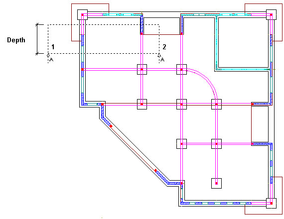

After a structure model has been edited, you can create a vertical section of the model at a user-defined location.
To create the section, select the option from:
- Menu: Formwork Drawings menu > Vertical section
- Ribbon: ASD - Drawings > Create drawings > Vertical section
- Toolbar: Drawings > Vertical section
- Command line: RBCX_DEF_V_SECTION.
Note: To define a depth for each segment of a broken line that determines a cut of a structure model, change the position of the depth line.

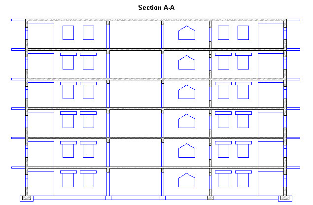

The generated vertical section, shown below, displays in the tree on the Positions tab of the Object Inspector dialog.
