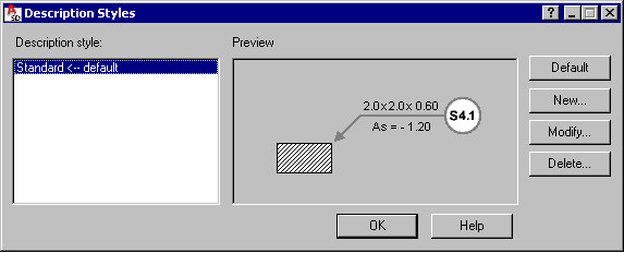

To begin defining the description style, open the Description Styles dialog from:
Under Description style, there is a list of styles defined for a selected description.
The Preview field displays a graphic representation of the selected description style.
Use the buttons on the right side of the dialog to work with element description styles:
