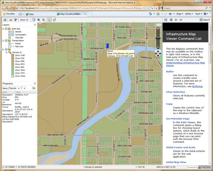

The Viewer displays a map along with the following optional components surrounding the map:
Basic Viewer
The tool bar, task list, task pane, and context menu can contain a combination of pre-defined and custom Infrastructure Map Server commands.
A web layout defines how the Viewer looks and operates for a map. One function of a web layout is to define which optional components display with the map. All of the optional components can be disabled, leaving just the map itself.
