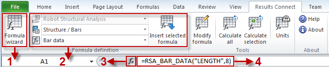

You can define formulas, that allow acquiring information from Autodesk Robot Structural Analysis Professional project, using either of the following ways.
1. Formula wizard
Insert a formula by using Formula wizard dialog.
You can access it from the Ribbon by clicking Results Connect tab Formula definition panel Formula wizard.
2. Insert selected formula
    You can specify the following settings by using selection drop-down list available on the Ribbon:
  • provider - specify a provider (program) from which information or results will be downloaded from
  • category - specify a category for formulas or select ALL to view an alphabetical list of formulas
    Note: Formulas are categorized by groups depending on type of information that can be obtained (for example Selection).
  • formula - specify a formula (for example List of selected objects).
After specifying settings above, you can insert the selected formula by using Insert formula dialog.
You can access it from the Ribbon by clicking Results Connect tab Formula definition panel Insert selected formula.
3. Insert function
Insert a formula with Insert Function dialog.
    You can access it from:
  • Ribbon - by clicking Formulas tab Function library panel Insert Function
  • Formula Bar - by clicking Insert Function icon.
4. Insert formula manually
Define a formula by typing a formula syntax manually in the address bar.
You can find all necessary information about each formula in the Formula list - Robot Structural Analysis and Formula list - Results Connect.
Note: A formula always starts with an equal sign (=) and text defined as an argument must be enclosed in quotation marks.
