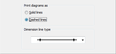

Click Printout in the Preferences dialog to expand the display to show the Symbols on printouts and Printouts options.
Click Symbols on printouts to select the type of diagram presentation, and the type of dimension line to be applied to printouts.
