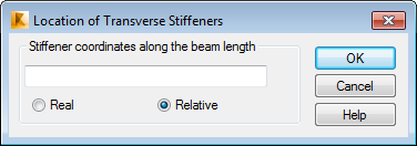

Location of Transverse Stiffeners (ANSI/AISC 360-05 and ANSI/AISC 360-10)
Use this dialog to determine the spacing of transverse stiffeners along the beam length, with real coordinates or in relation to the beam length.
Access
Dialog elements
Stiffener distribution along beam length
Enter the coordinates of the transverse stiffeners along the beam length, and specify if these coordinates are real or relative to the beam length.
Note:
  • Based on positions of transverse stiffeners, the program also calculates the length of the unstiffened web; this information is used to evaluate the shear strength V n according to Section G.
  • The program does not check if transverse stiffeners are geometrically correct according to Section G2.2.
