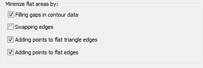

When you add contours to a surface definition, the Add Contour Data dialog box includes default settings to minimize flat areas, as shown in figure 6.
Figure 6: Default settings when adding contour data
If you add all your contour data in a single operation, use the three default settings shown in figure 6 to edit the contours and create a more accurate surface. AutoCAD Civil 3D uses these options to correct flat areas by checking the surrounding levels, interpolating new points, and subdividing triangles.
If you add contour data in two or more batches, clear the check boxes for the initial batches, so that contours are not edited based on incomplete data. When you add the final batch of contour data, select the three check boxes to correct the contours based on the full data set.
