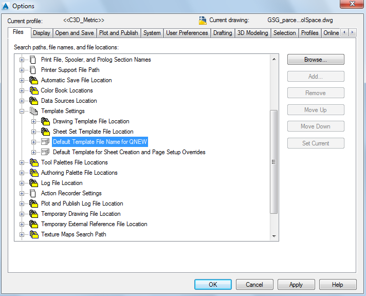

To change the default template
  1. Enter Options at the command line.
  2. In the Options dialog box, on the Files tab, expand Template Settings.
  3. Change the value for Default Template File Name for QNEW to the template that you want to use.
Figure 1: Set the default template
