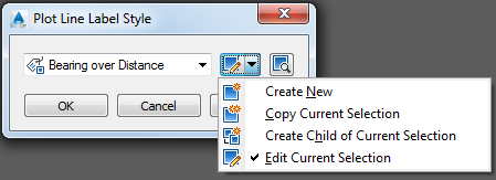

  1. Select a label, right-click and click Edit Label Style.
  2. This opens the <Object> Label Style dialog box as shown in figure 12 from which you can perform multiple commands to either create a new style, copy the existing style or child style, or edit currently selected style.
    Note:
    The Label Style Composer is accessed when you select Edit Current Selection.
Figure 12: Dialog box for accessing label style editing tools
