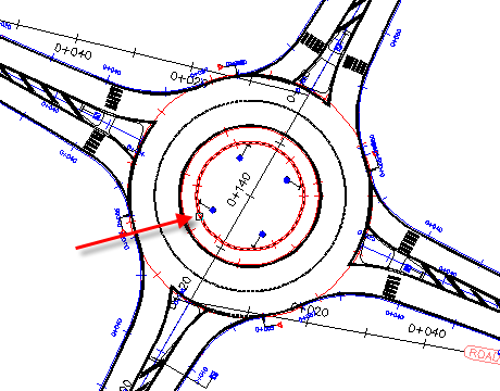

Select a a baseline roundabout
  1. Open Roundabout-Preset.dwg, which is located in the tutorials drawings folder.
  2. Click Modify tab Design panel Intersection.
  3. Click Intersection tab Modify Roundabout panel Edit Roundabout.
  4. Click the Roundabout_ISLAND alignment.
