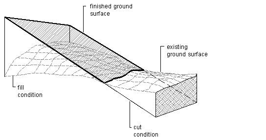

The composite volume method uses the points from two surfaces, as well as any location where the triangle edges between the two surfaces cross. The cut, fill, and net volumes are calculated based on the level differences between the two surfaces.
Click to view cut and fill conditions.
