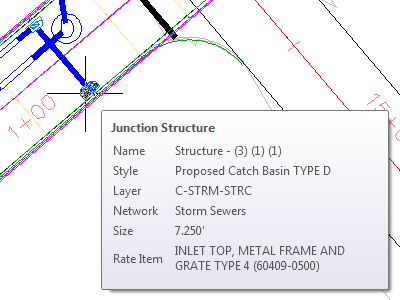

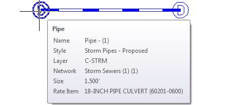

  5. Hover the cursor over one of the new structures.
    The tooltip displays the description and ID of each rate item that has been assigned to that structure.

  6. Hover the cursor over one of the gullies.
    The tooltip displays the description and ID of the rate items that have been assigned to the gully.
