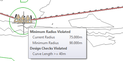

When a sub-element violates either a criteria or design check, a warning symbol is displayed on the sub-element in the drawing window, Alignment Elements vista, and Alignment Layout Parameters dialog box. When the cursor is hovered over a warning symbol in the drawing window, a tooltip displays information about the violation. If a design criteria has been violated, the tooltip displays the criteria that has been violated, as well as the minimum value required to meet the criteria. If a design check has been violated, the tooltip displays the name of the design check that has been violated.

The tooltips are a convenient way to review design criteria violations in the drawing window. Two violations are displayed in the tooltip:

Notice that the tooltip displays the design criteria and design checks that have been violated.
Notice that the name of the design check that has been violated is displayed in the tooltip. Also notice that warning symbols are not displayed in any other cells in this row. Design checks are custom mathematical formulas that return either a true or false value. They indicate whether the applicable elements violate the conditions in the design check, but do not specify how to correct the violation. You will learn more about design checks in Exercise 3: Working with Design Checks.
