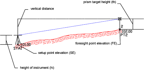

foresight
A point to which an instrument sighting is made to measure or establish its level or horizontal position.

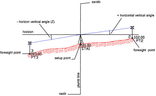

horizon
An axis that the scope of a theodolite or transit rotates about when moved vertically. The axis of rotation perpendicular to the vertical axis.

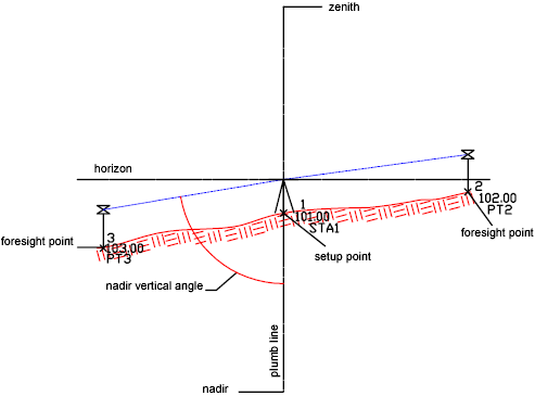

nadir angle
The nadir angle is opposite the zenith.

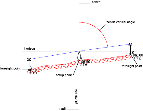

vertical angle
An angle above or below the horizontal plane. The angle is expressed in DDMMSS from this horizon. Vertical angles expressing a downhill slope from the instrument chainage are described with a negative value. Zenith angles are similar to vertical angles, except that a zenith angle has a vertical reference plane.

vertical distance
A distance measured along a sloped surface. For example, if you measure a distance from point A to point B that is on a 3:1 gradient, then that distance is longer than the distance measured horizontally.

zenith angle
The point directly overhead or the point where an observer's vertical line pierces the celestial sphere. Opposite zenith is the nadir.
