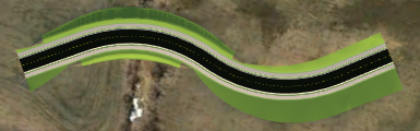

Detail of a corridor in an AutoCAD Civil 3D drawing. Design road displayed in InfraWorks using alignment and corridor data from the same drawing.
