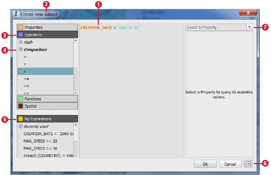

Use the Expression Editor to create expressions. With the exception of spatial (location-based) expressions, all InfraWorks 360 expressions consist of text you can type.
You can access the Expression Editor from numerous locations in the user interface. Click
to open the Expression Editor. See To create an expression for more information.
In the example above, the Expression Editor is used to create a subset that specifies the condition: Creation Date is greater than 01 January 2000.
This is where you view, create and modify expressions. Input expression elements manually, or select expression elements through the Expression Elements Menu or the Values Pane.
The title of the Expression Editor dialogue box will change depending on the type of expression you use. In the example above, the Expression Editor is used to create a subset that specifies the condition: Creation Date is greater than 01 January 2000.
In the example, the Operator category is expanded to show available Comparison operators.
InfraWorks 360 will support the conditions listed within the Properties, Operators, Functions and Spatial categories. See the Overview of Expression Elements for more information and examples for each category of Expression Elements.
View, modify and use recently used expressions.
Select a property from the drop-down list to query available values.
See Use Expressions for more about different ways to use expressions.
