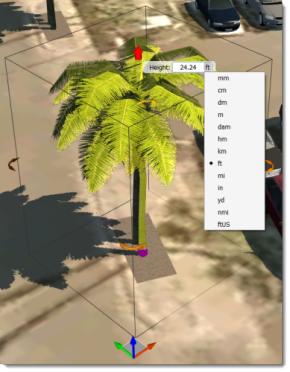

      Note: You can override the default unit that you specified in the unit configuration tab whenever you create or edit an object. Select the unit of measurement listed in the mini-toolbar for a selected object and choose the desired unit of measurement from the drop-down list.
