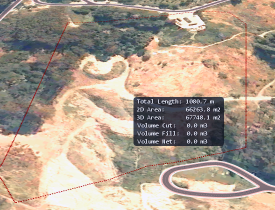

The Terrain Statistics tool measures total length, 2D & 3D area, as well as volume of a selected terrain area.
  1. Zoom out so you can see the space to measure.
  2. Click .
  3. Click the starting point and then click once for each additional point that makes up the perimeter of the desired area to measure. Double-click to finish.
    The measurement information appears over the perimeter.
    Volume information appears only if you adjusted the level of the measured area, for example, by adding a coverage and adjusting its height.
  4. To clear the current measurement, press Esc.
    The tool is still active and you can measure another area.
