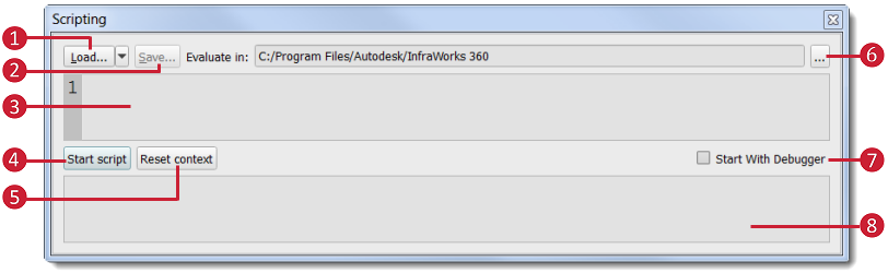

To create and run scripts from the Scripting Console
Create and run scripts using JavaScript to simplify workflows.
Click to open the Scripting Console.
  1. Load a JavaScript file to use.
  2. Save the current script.
  3. Click in the Scripting Area and type or paste in a script.
  4. Click to start the script.
  5. Reset the context of the script.
  6. Browse to a different location to evaluate the script in. This is the directory where the script will be run.
  7. Select Start with Debugger to open the debugger window once a script is started.
  8. Script results are returned here.
Additional tips
To customise imported features during import and/or configuration, see To use scripts during import.
