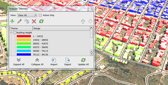

To theme features
Feature Themes allow you to highlight traffic emissions along streets, show power usage of buildings, compile census data and so on.
  1. Click to open the Feature Themes Palette.
  2. Click (Add a New Theme).
  3. In the Theme Parameters groups, do the following:
    • Enter a name for the theme.
    • Select a feature class for the theme.
    • Select the feature property to theme.
      For example, to create a theme that compares the height of buildings, select the Buildings feature class and then select the Roof Height property. The minimum and maximum values for that property are displayed. You can not change them.
    • For Distribution, indicate the method used to determine the theme range. For details, see the "Advanced Tips" section below.
    • Indicate the Number of Rules.
  4. Under Colour Range, specify the following:
    • Transparency: Use the slider to indicate how much of the underlying styling you can see once the theme is applied. A higher setting makes the theme more transparent.
    • Colour From and Colour To: InfraWorks 360 creates a colour ramp between the first colour in the theme (Colour From) and the Colour To selection. The Preview area displays the colour ramp.
    • Palette Type: For details, see the "Advanced Tips" section below.
  5. Click OK to apply the theme.
