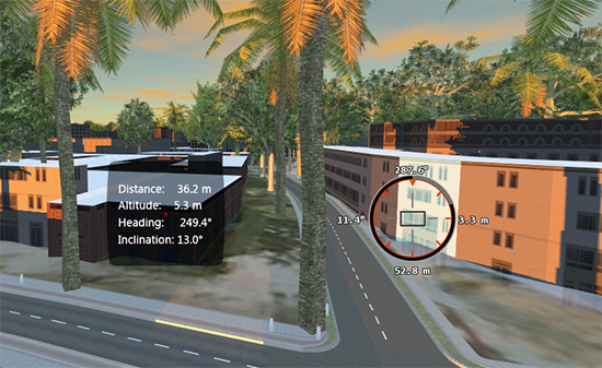

To measure from the current position to a target
Use the Rangefinder to measure distances relative to your current view position in model.

    Clear the most recent measurement Backspace
    Clear all current measurements Esc
    A label indicates the altitude, direction heading and angle of inclination to the target. You can continue measuring distances between the viewpoint and other targets by clicking more end points. Each one is labeled separately.

The distance will be measured even if the line between the viewpoint and the target is blocked by other objects.
A label indicates the altitude, direction heading and angle of inclination to each target you click. You can measure multiple targets in a session.
