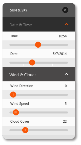

To change sun, wind and cloud settings
Adjust sun, wind and cloud settings, including date and time, to produce a range of atmospheric effects for your model.
The image on the left represents a sunny afternoon in late May. The image on the right represents an early winter morning.
  1. Click to display the Sun and Sky panel.
  2. Adjust the slider for each effect.
  Move slider to change a setting
Experiment with these settings to become familiar with the range of effects you can produce.
