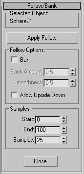

Although many of the settings are the same as in the Path constraint, this utility is not dynamic; you have to click the Apply Follow button each time you change an object's animation or the utility settings. When adjusting banking settings, move to the point at which the object is at the sharpest turn, then alternately click Apply Follow and adjust the banking settings to get the right affect at the extreme corner.

Displays the name of the current selection. If more than one object is selected, "Multiple Selected" displays.
Click to apply the settings and generate rotation keys. Each time you click this button, rotation keys in the specified range of frames (set in the Samples group) are deleted and regenerated.
Contains the parameters that specify whether or not to use banking, and the banking settings.
Specifies the range of frames over which rotation keys are generated, and the number of keys to be generated.
