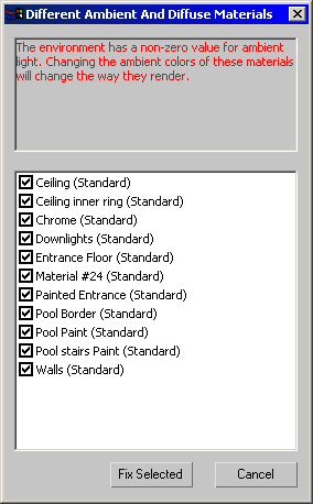

This dialog appears after clicking Find All or Find Selected.
