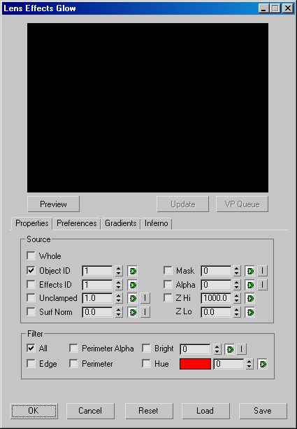

The Lens Effects Glow dialog contains a preview window, and an area below to control the parameters of Glow.
The Lens Effect Glow dialog contains four tabs: Properties, Preferences, Gradients, and Inferno
