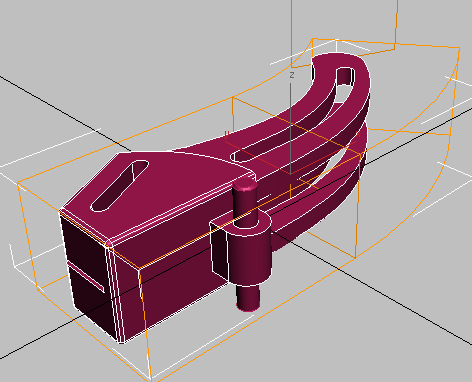

- From the Modifier List, choose Bend.
- Set the Bend parameters as follows:
- Axis = X
- Angle = 70 degrees
- Direction = –90

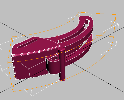

The results are not quite what we want.
All of the object is bent, and the base has moved away from the pivot pin. What we want is to limit the bend so that the blades of the clamp are bent, but the base remains unchanged and in the same place.

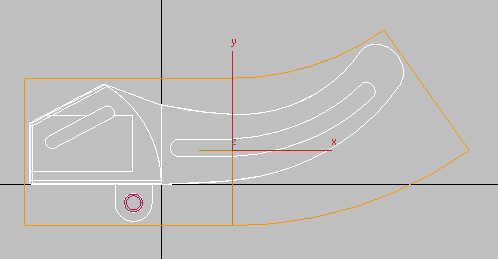

- In the Bend Parameters rollout
Limits group, turn on Limit Effect, then change the value of Upper Limit to 70mm.
Now only the ends of the clamp blades are bent.
This is easier to see in the Top viewport.
