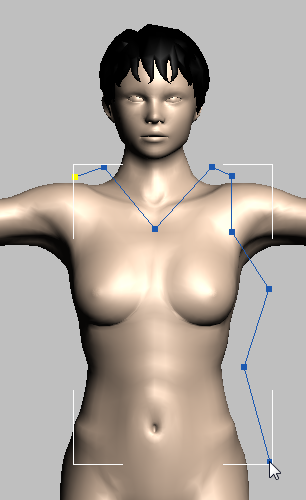

  3. Begin by drawing the top of the shoulder seam, and the neckline.
  4. Continue down along the side of the model, roughly following the contour of the figure, and adding a bit of flare for the bust. Extend the outline to the level of the model’s hips.

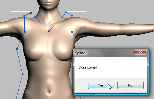

  6. Continue up the model’s right side, keeping the vertices as symmetrical as you can.
  7. End the last segment of the outline by clicking over the first vertex, and when 3ds Max prompts you to close the spline, click Yes.
  8. At this point, if you want to adjust the vertices, go to the Modify panel, turn on (Vertex) to go to the Vertex sub-object level, and move vertices until you have a symmetrical pattern with which you are comfortable.

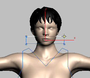

Draw the outline of the collar:

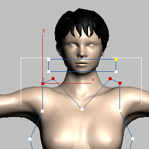

  1. On the Create panel, activate (Shapes) if it isn’t already active, and then activate Rectangle.
  2. In the viewport, draw a rectangle that will be the pattern for the collar. The rectangle should be above the neckline, in front of the model’s mouth.

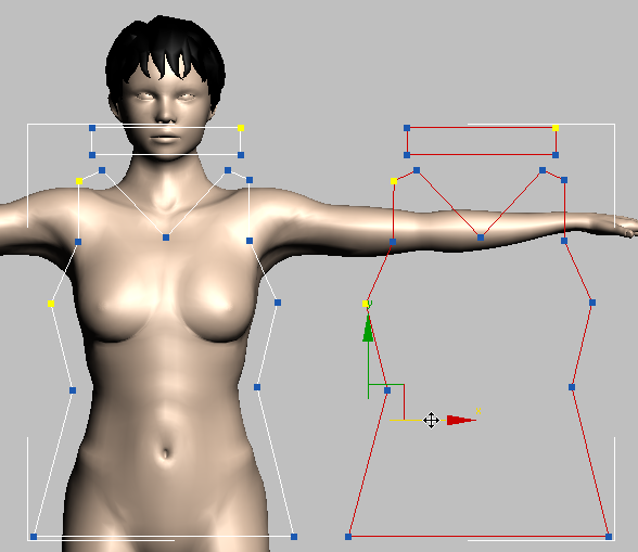

Copy the pullover outline to create the back panel:
  1. Click (Spline) to go to the Spline sub-object level, and drag to select the entire pattern.
  2. Activate (Select And Move), then +move the pullover pattern to the right to make a clone of the original splines.

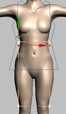

  2. On the Create panel, activate (Shapes) if it is not already active, then click to activate Rectangle.
  3. Begin the skirt outline by drawing a rectangle. The skirt should begin at the model’s waist, above the navel, and end at the model’s knees.
  4. Change the name of the rectangle to Skirt Pattern.
  5. Right-click, and from the Transform (lower right) quadrant of the quad menu, choose Convert To Convert To Editable Spline.
  6. Go to the Modify panel, and activate (Segments).
  7. Select the two vertical sides of the rectangle.
  8. On the Geometry rollout, scroll down to find the Divide button, then click Divide to add a vertex to the side segments.
  9. Activate (Vertex). Drag a box to select all the vertices in the skirt, then right-click, and from the Tools 1 (upper left) quadrant of the quad menu, choose Corner.
  10. Drag a box to select the new, middle vertices along the side of the skirt pattern.
  11. Move the vertices vertically so they are just below the top vertices of the rectangle. They should form a waistband for the skirt.

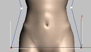

Change the hem line to a rounded hem:
  1. On the main toolbar, activate (Select And Non-Uniform Scale), then from the Pivot Point flyout, choose (Use Selection Center).
  2. Still at the Vertex sub-object level, select the two lower vertices of the skirt pattern. These are the vertices that define the hem line.
  3. Drag the vertices outward along the X axis to create a flare for the skirt.
  4. Right-click, and choose from the Tools 1 (upper left) quadrant of the quad menu, choose Bezier Corner.
    This is a temporary measure so you can shape the hem.
  5. Move the lower tangent handles, along the hemline, downward to create a rounded hem for the skirt.
