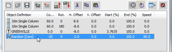

- On the toolbar, click
(Add new element). 3ds Max Design adds an element to the list. By default, this is a vehicle.
- If the new element is not the last in the list, click
(Move selected element down) until it becomes the last.

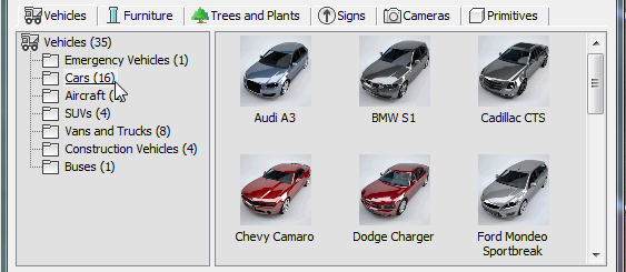

- On the element editor, in the hierarchy at the left, click to choose the Cars entry.

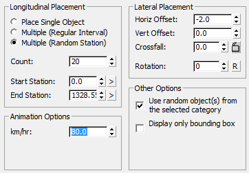

- Set the parameters for car placement as follows:
- Longitudinal Placement group: Choose Multiple (Random Station), and make sure that Count is set to the default value of 20.
- Lateral Placement group: Set Horiz[ontal] Offset to –2.0.
- Animation Options group: Set km/hr to 80.0.
- Other Options group: Turn on "Use random object(s) from the selected category."
- Click Apply.

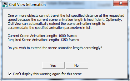

3ds Max Design displays a warning that asks if you want to fit the scene's animation length to the value implied by animating the cars.
- Click Yes.

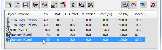

- In the elements list, click to highlight the Random [Cars] entry.
(Copy Element), then click
(Paste Element) to add a duplicate Cars entry to the list.
- Click to highlight the new Random [Cars] entry.

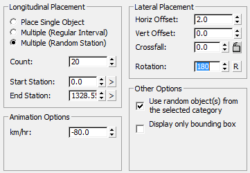

- Set Horiz[ontal] Offset to 2.0.
- Set Rotation to 180.
- Animation Options group: Set km/hr to –80.0.
- Click Apply.
