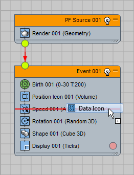

  1. Start or reset 3ds Max, and then create a default Particle Flow system. Press 6 to open Particle View.
  2. From the Particle View depot, drag and drop the Data Icon operator on top of the Speed operator in Event 001, so that when you release the mouse button, the Data Icon operator replaces the Speed operator.

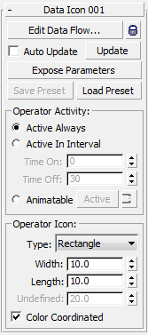

  3. Click the Data Icon 001 operator.
    The Data Icon 001 rollout appears in Particle View.
  4. At the top of the rollout, click the Edit Data Flow button.

  1. In Particle View highlight the Data Icon operator, if necessary, and then in the Data Icon 001 rollout Operator Icon group, change the Type from Rectangle to Arrow.
    The icon changes to an arrow, which makes it easy to see its orientation.

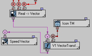

    You can use the Icon suboperator to request the transformation matrix of the icon.
  2. In Data View, drag the Icon suboperator from the depot to an empty area of the schematic window.
  3. Click the Icon Pivot suboperator and then, from the Icon Property drop-down list, choose Icon TM. TM stands for transformation matrix.
    You'll use the Function suboperator to multiply the speed vector by the icon matrix.
  4. Add a Function suboperator in an empty part of the window.
  5. Click the Function suboperator and then set the Second Operand Type to Matrix. Also set Function to Vector Transform.
  6. Click the wire between the Convert suboperator (Real --> Vector) and the Output Standard suboperator (Speed Vector) to highlight it and then press to remove it.
  7. Wire the output of the Convert suboperator to the V1 input of the Function suboperator.
  8. Wire the output of the Icon suboperator to the M2 input of the Function suboperator. Note that you're wiring between the same-color connectors.
  9. Wire the output of the Function suboperator to the input of the Output Standard suboperator.

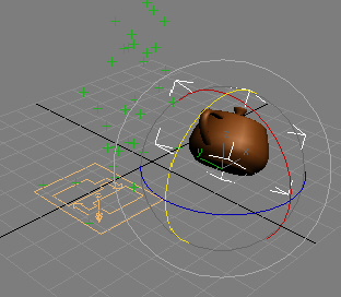

It's just as easy to use a reference object's orientation to set the particle direction.
  1. Add a teapot to the scene.
  2. In the Data Flow window, click to highlight the Icon TM suboperator and then press to get rid of it.
  3. Add a Select Object suboperator to an empty area of the Data Flow.
  4. Click to highlight the Select Object suboperator, then on the Select Object 001 rollout, click the Single Object button (which initially reads "None"). In a viewport, click the teapot.
    The teapot's name appears on the button and on the suboperator node.
  5. Next, add an Object suboperator.
    This lets you specify which object property to retrieve.
  6. Highlight the Object suboperator and then, from the Object Property drop-down list, choose Object TM.
  7. Connect the Select Object suboperator to the Object suboperator, and then connect the Object suboperator to the M2 input of the Function suboperator.
    Now, when you rotate the teapot about the X and Y axes, it has the same effect on the particle stream as did rotating the icon.

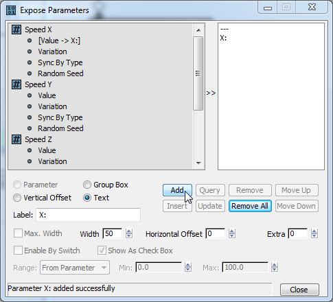

Part 2: Save the Data Operator as a Standard Operator

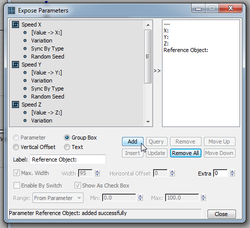

Once you've created a Data operator, you can save it as a regular Particle Flow operator. First, you expose the most important parameters. In this case, they're the vector components; that is, the Scalar suboperator Value settings, and the button of the Select Object suboperator.
  1. In Particle View, make sure the Data Icon operator is highlighted. On the rollout, click the Expose Parameters button.
    This opens the Expose Parameters dialog, which lets you collect and identify the parameters to be exposed. Basically, you use it to create your operator UI.
  2. In the left-hand list, highlight the Value entry under Speed X. In the Label Field below the list, type X:, and then click the Add button.
    The entry in the left-hand list changes to [Value -> X:)], and the new label appears in the right-hand list.
    More important, the added parameter appears on a new Parameters rollout in Particle View. This shows the exposed parameters, and is available to anyone who uses your operator.
  3. Do the same for Speed Y Value and Speed Z Value, labeling them Y: and Z:, respectively.
  4. Also add Teapot001 Object, labeling it Reference Object:. Set Width to its maximum of 95 so there's enough room for the button and label on the rollout. Then choose Group Box. Finally, click Add.
  5. On the Expose Parameters dialog, click the Close button.
    All four parameters now appear on the Parameters rollout.

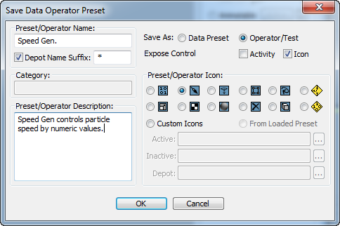

    The next step is to save the Data operator as a preset.
  6. On the Control rollout in Particle View, click the Save Preset button.
    This opens the Save Data Operator Preset dialog.
  7. In the Preset/Operator Name field, enter a name, such as Speed Gen.
  8. To the right of this field, set Save As to Operator/Test.
  9. In the Preset/Operator Description field, enter a description, such as this one: Speed Gen controls particle speed by numeric values..
  10. In the Preset/Operator Icon group, choose any icon you like.
  11. Click the OK button.
    A message informs you that the preset has been saved.

  15. Click the Speed Gen 001 operator, and then on the rollout in Particle View, click the Reference Object button and then in a viewport, click the teapot.
  16. Rotate the teapot, then drag the time slider.
    The teapot orientation controls the particle stream direction.
