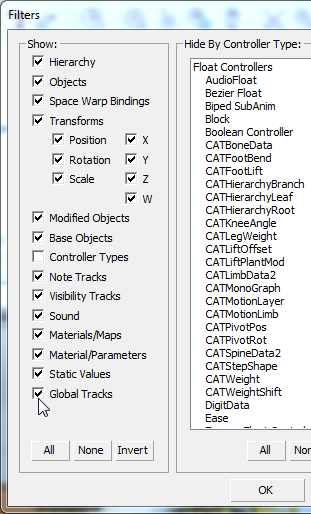

    Tip: If the Sound track isn't visible after you switch to Dope Sheet mode, click Keys: Dope Sheet toolbar (Filters), and then in the Filters dialog Show group, click to turn on Global Tracks.

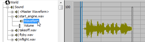

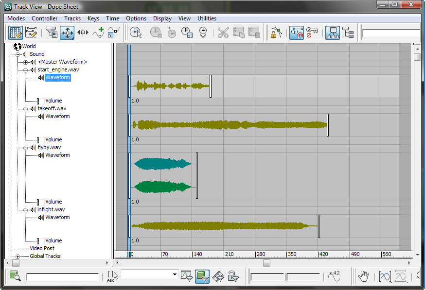

  1. On the Dope Sheet track view hierarchy, expand the Sound track to display the master track as well as four additional tracks, each of which represents a sound file you loaded into the scene.
  2. Expand each track. In the Dope Sheet window, you can see the waveform of the sound.
    A waveform is an image that represents an audio signal, showing changes in amplitude over time. Soft sounds, like footsteps, produce a narrow pattern, whereas sharp sounds, like the scrape of a chair leg, show a wider pattern. Waveforms help you visualize the events in an audio recording.
    The Master Waveform track provides a visual compilation of all tracks.
  3. Collapse the master track to view just the waveforms and volume components of the four individual sound tracks.
    The first, second, and fourth sound tracks were recorded in mono and show a single waveform. The third sound track, flyby.wav, was recorded in stereo and displays two waveforms, one for its left and another for its right channel.
  4. Play the animation to hear the sound files.
    The segments overlap and produce a jumbled sound. You need to adjust the timing so each plays back at a more logical place in the animation.

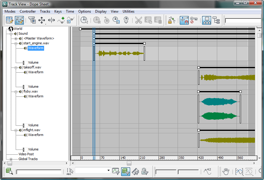

  6. For now, concentrate on just the start_engine.wav track by selecting the other track range bars in the Dope Sheet and moving them to the right, past frame 200.
    Tip: Alternatively, you could temporarily mute the sound tracks in Track View by selecting their file names in the ProSound dialog and turning off the Active checkbox, as described in the previous procedure.
    Scrub the animation.
    The plane starts to move down the runway at frame 160. This is where you want to place the start of the takeoff.wav audio segment.
  7. Click the takeoff.wav range bar and drag it until the segment waveform starts at frame 160.

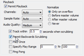

  1. To hear the audio in reverse when scrubbing, highlight, then right-click the Sound track in the Dope Sheet hierarchy and from the quad menu choose Properties. In the ProSound dialog Playback group, turn on Permit Backwards Scrubbing.
  2. Try scrubbing the animation back and forth.
    Now you can hear all audio in the scene play in reverse.
