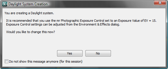

    3ds Max displays a dialog that asks if you want to add a Logarithmic exposure control to the scene.
  4. Click Yes to add the exposure control.
    Note: If you opened wt_material.max, the scene already includes a Logarithmic exposure control, and this prompt does not appear.

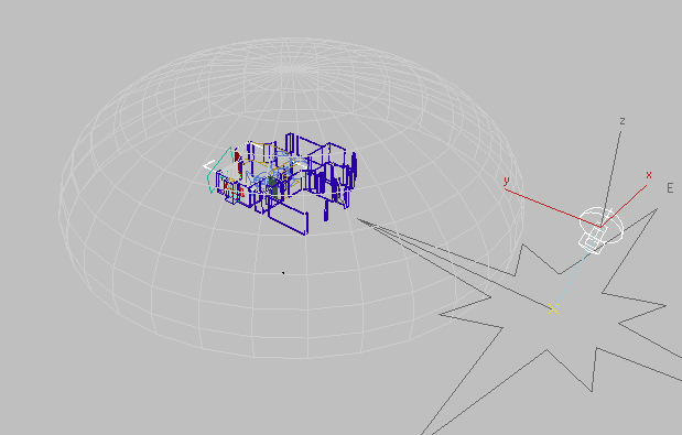

  5. Drag in an empty area of the Perspective viewport. A compass rose appears. Release the mouse.
  6. Back in the Perspective viewport, drag to set the height of the Daylight light. Click to complete creation of the Daylight system.
    Note: The scene position of the compass and the height of the light don't really matter: 3ds Max will calculate correct values for daylight. Later, you will adjust the orientation of the compass to reflect the geographic orientation of your model.
