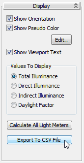

  1. In the Camera01 viewport, select the Light Meter helper object.
  2. Go to the Modify panel Display rollout and click Export To CSV File.
  3. On the Save Light Meter Output As CSV File dialog, enter my_arena.csv as the file name, then click Save.
    Note: A prepared CSV file, arena.csv, has been saved to the \export folder as well.
    3ds Max saves the data generated by the Light Meter object in CSV format to the \export folder of your project directory.
  4. Navigate to your \export folder and open the newly saved file.

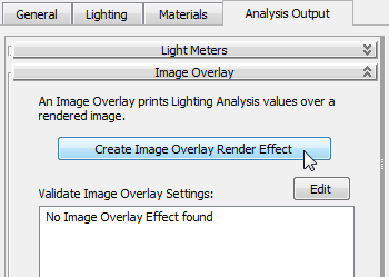

  1. Drag the time slider to frame 7. From the main menu, choose Lighting Analysis Lighting Analysis Assistant to open the Lighting Analysis Assistant dialog.
  2. Go to the Analysis Output panel if it is not already open, and on the Image Overlay rollout, click Create Image Overlay Render Effect.
    3ds Max opens the Environment And Effects dialog Effects panel.

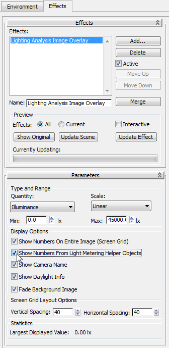

  3. On Effects rollout, click Lighting Analysis Image Overlay to highlight it, and then in the Parameters rollout Display Options group, make sure all the options are turned on. Keep the dialog open.

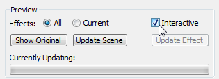

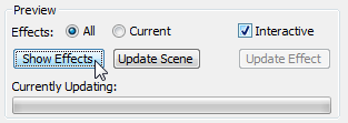

  4. In the Effects rollout Preview group, turn on Interactive.
    3ds Max renders the scene.

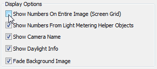

  1. In the Environment And Effects dialog Parameters rollout Display Options group, turn off Show Numbers On Entire Image (Screen Grid).
    Now only the luminance values returned by the sampling points of the Light Meter you created for the court surface are displayed.

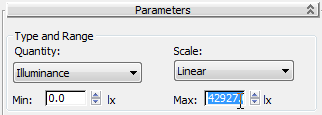

  2. In the Environment And Effects dialog Effects panel Parameters rollout Type And Range group, change the value of Max to 42927.0, and then press . (If your rendering shows a higher Maximum Illuminance value, choose a Max value that is about 10 greater than the value you see.)
    By lowering the maximum range, the sample values display in their full color-coded range, from blue (low luminance) to red (high luminance). This is most noticeable near the windows.

  5. In the Display Options group, turn off Show Numbers From Light Metering Helper Objects and turn on Show Numbers On Entire Image.
    The Light Meter luminance data is now sampled from 2D points on the image surface. You can set the density of sampling points on the surface plane.

  7. In the Effects rollout Preview group, click Show Original to view the scene without the lighting data. Click Show Effects to redisplay the data.
