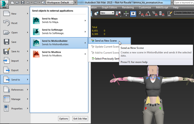

Send the scene to MotionBuilder:
- Open the
Application menu and choose Send To
Send To MotionBuilder
Send As New Scene.
3ds Max displays a warning that no objects have been selected.
- Click Yes to send the entire scene.

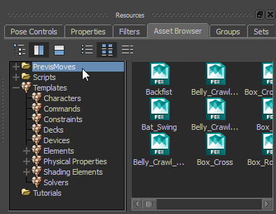

- On the Resources window
Asset Browser tab (at the lower right of the MotionBuilder window), click to highlight the PrevisMoves folder.
This folder contains a variety of motions, stored as FBX files.
- On the Navigator window, at the lower left of the MotionBuilder window, click to go to the Story tab.
- In the PrevisMoves folder, locate the Bat_Swing motion clip, then drag it to the Story tab and drop it on the lower of the two timelines.
