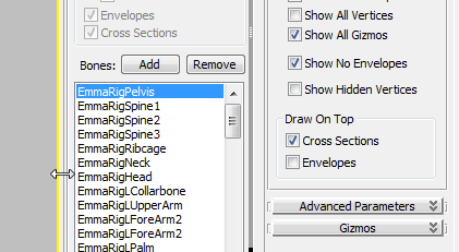

    Tip: The Skin modifier has quite a few parameters spread out among several rollouts. In some cases you might want to see more settings than can fit comfortably in a single column. To expand the command panel, position the mouse cursor over the left edge so it becomes a horizontal, two-headed arrow, and drag leftward until you see two columns.
    Drag the left edge of the command panel to the left to expand it to multiple columns.

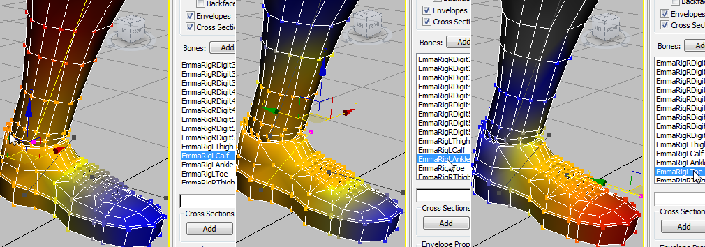

  4. Select each of the foot bones in turn: EmmaRigLCalf, EmmaRigLAnkle, and EmmaRigLToe.
    From left to right: calf, ankle, and toe bone selected.
    End with EmmaRigLAnkle selected. The shading (orange, yellow, and blue) indicates that most of the vertices’ weights for this bone are less than 0.5, which is undesirable.

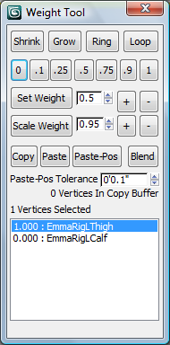

    In this section you’ll continue to block out the leg weighting, using the convenient, powerful Weight Tool dialog.
    Given a selection of vertices with the same bone and weight assignments, Weight Tool lists all bones that affect the vertices along with the corresponding Weight values. It also lets you edit the Weight value for the current vertex selection and bone assignment, setting either an absolute Weight value or adjusting the weights of the vertices relative to their current values. In addition, Weight Tool provides controls for copying and pasting Weight values and controls such as Ring and Loop for modifying the vertex selection.
    Note: If you select multiple vertices with different Weight values and bone assignments, the Weight Tool dialog shows the settings for the vertex with the lowest sub-object ID. To see settings for more than one vertex at a time, use the spreadsheet-like Weight Table.
  1. Near the bottom of the Parameters rollout, click (Weight Tool).
    The Weight Tool dialog opens. Drag it to a convenient, out-of-the-way location. You can keep it open as you work.
  2. Select different vertices while keeping on eye on the list at the bottom of the Weight Tool dialog.
    The list shows the selected vertex’s bone assignments and the Weight value for each assignment. Note that the Weight values always add up to 1.0. If, for example, you change the Weight value for a particular bone for a vertex that’s influenced by three different bones, 3ds Max changes the values for the other two bones in the opposite direction, in proportion to their current values.
    Note also that the Set Weight value doesn’t change; this is a write-only field.
  3. Select all the vertices in the lower half of the knee area, down to the bottom of the Capri pants.
  4. Make sure the calf bone is highlighted in the Weight Tool list, and then click the 1 button on the Weight Tool dialog.
    This sets the Weight value for all selected vertices to 1.0 with respect to the calf bone. Note that the weights for the other two bones in the list are now 0. You can get rid of 0 weights in the entire mesh by clicking Advanced Parameters rollout Remove Zero Weights, but thats not necessary at the moment.

    Currently these vertices are weighted only for the pelvis bone, so you need to add weighting for the thigh bone.
  4. Select the thigh bone, set the vertex weights to 0.5, and adjust from there. For example, the lowest three vertices on this crease stick out too much, so you need to increase the thigh-bone weighting for them compared to the other six vertices.
