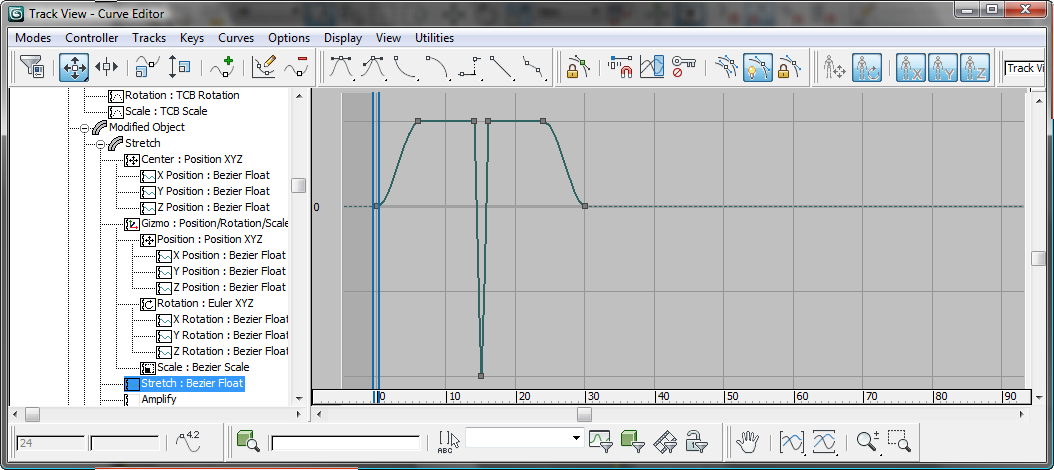

  8. You need to “bracket” the squash so it doesn’t begin before impact, and goes away when the ball rebounds.
    +copy the key at frame 6 to the following frames:
    • Frame 14
    • Frame 16
    • Frame 24

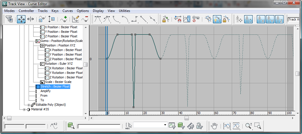

Repeat the stretch and squash:
  1. In the Curve Editor controller window, locate the track for the Stretch parameter.
    The hierarchy looks like Basketball Modified Object Stretch Stretch : Bezier Float. You have to scroll down to get past several position, rotation, and scale tracks that you arent using in this exercise.
  2. On the Track View - Curve Editor toolbar, click (Parameter Curve Out-Of-Range Types).
  3. In the Param Curve Out-Of-Range Types dialog, click the outgoing button for the Cycle option, and then click OK.
    Now the squash and stretch pattern repeats indefinitely.
