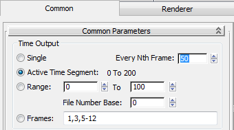

Render sample frames:
While the preview shows the animation's speed and rhythm, it doesn't show how frames look when fully rendered. To get a better idea of the look of the animation, you can render sample frames.
This will render five frames that are sampled along the duration of the animation, from frame 0 to frame 200. (Rendering five frames will take probably 5 to 10 minutes: Adjust the Every Nth Frame value to suit the time you want to spend on this lesson.)

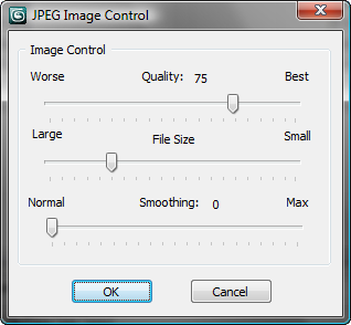

When you render an animation to a still-image file type such as JPEG, 3ds Max creates a sequence of image files. Each has the file name you chose (wt_samples) followed by a sequence number (for example, wt_samples0000.jpg).
3ds Max opens a JPEG Image Control dialog.
As each image is rendered, it is stored in the \renderoutput folder. When a frame is completed, view it to see if there is a problem with it. If something seems wrong, stop the rendering by clicking Cancel in the Rendering dialog or by pressing Esc. Correct the problem, and then render sample frames once more. This sampling process should help you spot problems before you take the time to render the full animation.
