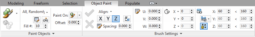

  1. If the ribbon isn’t already open, then on the main toolbar click (Graphite Modeling Tools). Click the expand/collapse icon until you can see the full height of the ribbon.
  2. On the ribbon, click the Object Paint tab.
  3. On the Paint Objects panel, click (Edit Object List).
    3ds Max opens a Paint Objects dialog.

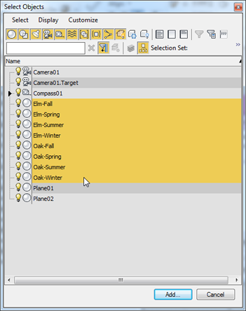

  4. On the dialog, click Add.
    3ds Max opens a Select Objects dialog.
  5. Click and +click to select all eight tree objects, and then click Add.
    The grove you paint in this lesson will be an eclectic one. Another time, you might want to choose only spring trees, for example, or fall ones.
  6. Close the Paint Objects dialog.
    Now you are able to paint the trees onto the terrain. By default, the Paint Objects tool uses the first object in the set you selected.
Set up the Object Paint tool:
  1. On the Paint Objects panel, choose All, Randomly from the drop-down list.
    When you paint, the trees will appear in random order.
  2. Also on the Paint Objects panel, open the Paint On drop-down list and choose Selected Objects.
  3. On the Brush Settings panel, set Spacing to 40.00 units.
  4. Also on the Brush Settings panel, open the Align drop-down list, and turn off Align To Normal.
    We want the trees to grow vertically, not to lean wherever the terrain is not flat.
  5. The right-hand side of the Brush Settings panel has three groups of controls: Scatter, Rotate, and Scale. In this tutorial, we don’t use the Scatter tools, but do make adjustments to the other two groups.
    In the Brush Settings panel Rotate group, click the drop-down arrow next to the Z coordinate field, and in the drop-down list, turn on Random Z.
    When you paint, the trees will have a random amount of rotation about their vertical (Z) axis.
  6. In the Brush Settings panel Scale group, make sure axis Lock (Uniform Scale)) is turned on, then open the Scale Type drop-down list, and choose Random.
    After you choose Random, the Scale group shows a range of values for the axes; because Axis Lock is on, you can change only the X axis values.
  7. Also in the Scale group, set the minimum X value (on the left) to 60 and the maximum X value (on the right) to 160.
    The trees will vary in height and girth from 60 units to 160.

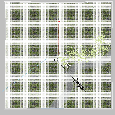

Paint the proxy trees:
  1. Select the terrain object, Plane01.
    Remember that Object Paint is set to paint onto the currently selected object.
  2. Maximize the Top viewport, and click (Zoom Extents Selected).
  3. On the Paint Objects panel, open the Paint drop-down menu and choose Paint With Object(s) In List.
    (Paint With Object(s) In List) is now active.
  4. Hold down the mouse button as you drag over the terrain object. 3ds Max adds copies of trees to the scene. The trees are at least 40 units apart.
    You can paint the trees densely together, but on the near bank of the stream, avoid painting directly in front of the camera’s line of sight.
