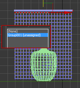

Select the curtain, and on the Modify panel modifier stack, expand the mCloth entry so the Vertex sub-object level is shown. Click the Vertex entry.
The Modify panel changes to display the Soft Selection and Group rollouts, and the curtain's vertices appear in the viewports.
In the Left viewport, select the top row of vertices. Then, on the Group rollout, click Make Group. When the Make Group dialog appears, click OK to continue.
Main image: Curtain in Left viewport with top row of vertices selected
Inset: Group list on the Modify panel
The list on the Group rollout now shows the group you just created, Group001, and its unassigned status. You'll assign a Node constraint to the group, which means that those vertices will "stick" to the rod during the simulation.
In the Group rollout Constraint group, click the Node button and then select the curtain rod in a viewport.
The Group001 item in the list now shows that it's constrained as a node to Cylinder001, the curtain rod.
