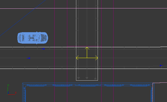

  3. In the Top viewport, click just in front of the building whose wireframe color is blue, then drag upward, press , and click again near the top of the walkway to create another straight flow that intersects the first one. Right-click to end flow creation.
    A second flow for the crosswalk and walkway intersects the first.
    Notice how Populate displays four-way arrows where the flows cross each other.
    It is important to make sure these arrows appear: If you don't see them, it means the flows did not intersect correctly. When the intersection is incorrect, pedestrians on one flow might walk through pedestrians on the other!
    The angle between intersecting flows can be between 45 and 135 degrees. Pedestrians that encounter the intersection sometimes change direction and turn left or right instead of continuing ahead.

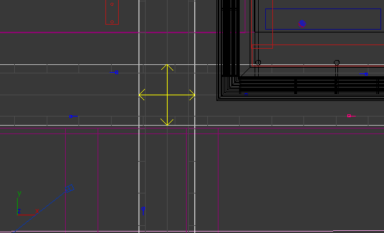

Add a flow for the near sidewalk:
  1. Make sure (Create Flow) is still on.
  2. On the Define Flows panel, change the value of Width back to 12.
  3. Click in the Top viewport to create a flow along the near sidewalk. Make sure that arrows appear where it intersects with the crosswalk/walkway flow. If the new flow is too close to the starting point of the previous one, Populate won't generate the intersection correctly.
    Flow for the near sidewalk intersects the flow from the crosswalk.
    In this case, the intersection shows only three arrows, because the crosswalk/walkway intersection is near the end of the crosswalk flow.

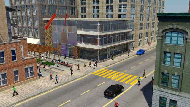

    This time, the status bar indicates that Populate is creating more pedestrians than it did the first time. When the calculations are done, the scene has more of the look of a city at midday.

    In this long shot, the seated characters are hard to see.
  10. Click the Point-Of-View (POV) viewport label menu (the middle label), and choose Cameras Camera002.
    In the Camera002 medium shot the new seated figures show up well.

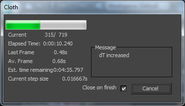

(Optional) Increase the length of the flag animation:
    You might notice a glitch in using Populate Simulate to extend the animation length: The flags above the walkway cease to move at the original animation length of 300 frames. You can correct this as follows:
  1. Select flag01.
  2. in the Modify panel Object rollout Simulation group, click Simulate.
    3ds Max displays a progress dialog while it extends the Cloth simulation.
  3. Repeat these steps for flag02.
    The motion of the flags still winds down, as the only force acting on them is gravity. But the motion does continue beyond frame 300.
