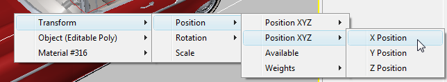

- Right-click the car body object and from the quad menu, choose Wire Parameters.
- From the pop-up menu, choose Transform
Position
(2nd) Position XYZ
X Position.

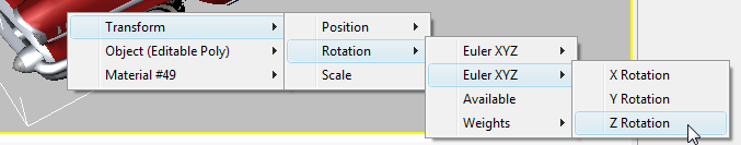

Rotation
(2nd) Euler XYZ
Z Rotation.

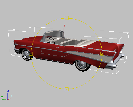

- In the Top viewport, select the Chassis object and rotate it –90 degrees (clockwise) so that its front bumper points at 12 o’clock.
The car is now oriented on the World Y axis, so you will begin working in this coordinate system.

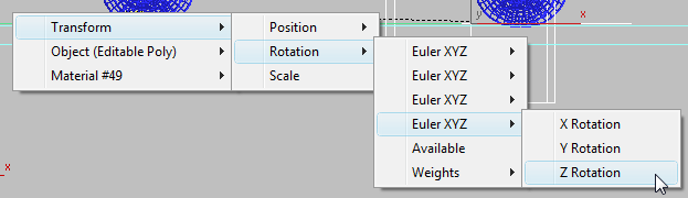

Rotate the wheels in World Y coordinates:

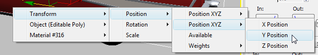

- Select the Chassis, then right-click and from the quad menu, choose Wire Parameters.
- From the menu, choose Transform
Position
(2nd) Position XYZ
Y Position.
- Click the front left wheel (Wheel-FL).
Rotation
(3rd) Euler XYZ
Z Rotation.
- On the Parameter Wiring dialog, click the right-pointing arrow above Control Direction to ensure that the Chassis Y position is controlling the Wheel-FL Z rotation.
- On the right-hand Expressions panel, type /13, then click Connect.
The expression for the left-hand wheel should be Y_Position/13
- Click Connect.
- Repeat steps 2 to 7 for each of the other three wheels.
Note: The expression for the right-hand wheels should be –Y_Position/13.

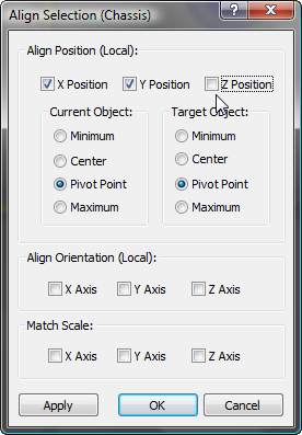

- With the Point helper still selected, on the main toolbar click
(Align), then in any viewport, click the Chassis object.
- In the Align Selection dialog
Align Position group, make sure X Position and Y Position are on and Z position is off.
- In the Current Object and Target Object groups, make sure Pivot Point is chosen, then click OK.

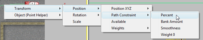

- Select and right-click the Point helper, then from the menu choose Wire Parameters.
Position
Path Constraint
Percent.
- Click one of the car wheels and choose Transform
Rotation
(4th) Euler Rotation
Z Rotation.
