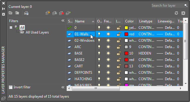

    This file contains a lot of elements that aren't necessary for the 3D walkthrough. Using the Layer Manager, you can hide all the elements that you will not use. The only layers that are required for this tutorial are 01-Walls and 02-Windows.

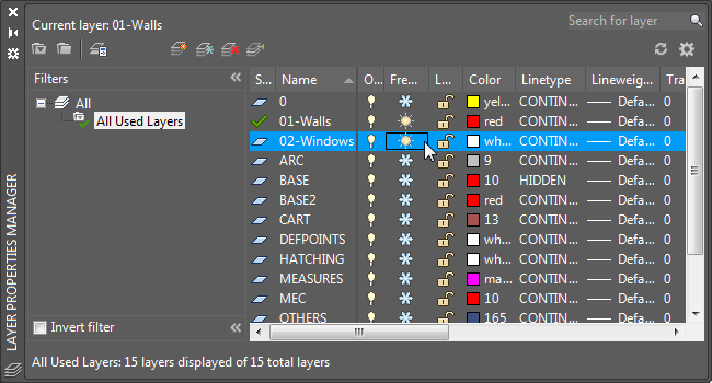

  1. On the ribbon Home tab Layers panel, click (Layer Properties).
    AutoCAD opens the Layer Properties Manager dialog.
  2. On the Layer Properties Manager, click to select the layer 01-Walls.
  3. On the Layer Properties Manager toolbar, click (Set Current) to make this layer current.

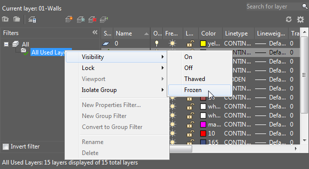

  4. In the left pane, right-click All Used Layers, then choose Visibility Frozen to freeze all the layers. A dialog appears to inform you that the current layer cannot be frozen. Click Close.
  5. Click the icon to unfreeze the 02-Windows layer as well.
  6. Click (New Layer). Name this new layer 3DWalls. Use the square color icon in the Color column to change its color to blue.
  7. Highlight the new layer (3DWalls) and click (Set Current).
  8. Close the Layer Manager.

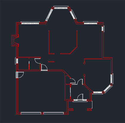

    The drawing should now show walls, windows, and doors.

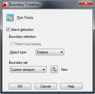

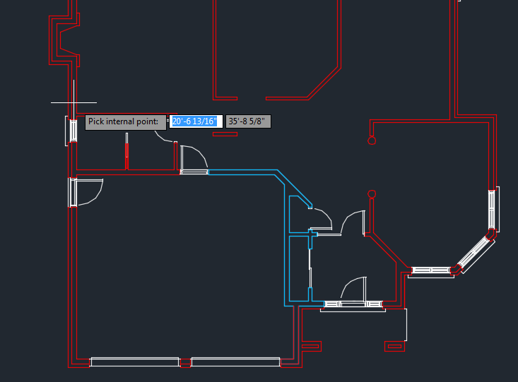

  3. Type bpoly and then press .
    AutoCAD opens a Boundary Creation dialog.
  4. In the Boundary Creation dialog, click (Pick Points).
  5. Click inside the wall shown in the following illustration, and then press .
    AutoCAD creates a polyline.

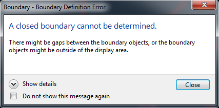

  6. Retype bpoly. Click Pick Points once again, then click inside the wall shown in the following illustration. Press .
    This time, AutoCAD does not create a polyline. Instead, it dislays an error message:
    (If AutoCAD does attempts to create polyline instead of displaying this dialog, press +Z.)
    The problem is that the wall is not continuous. You must close the gap before you can create a polyline.
  7. Dismiss the dialog, then press to exit the Bpoly command.

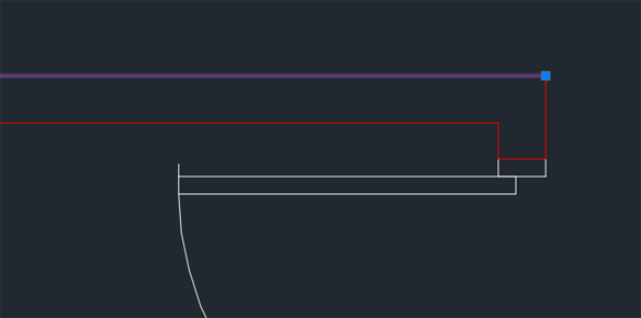

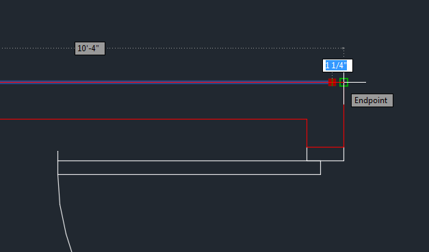

  8. Zoom in until you get a better view of the gap between the walls, which you can see at the right of this illustration:
  9. Fix the gap by extending the line on the left to the endpoint of the next wall. Click the line to select it, then drag from its endpoint to the endpoint of the other wall.
    Now the wall should be closed.

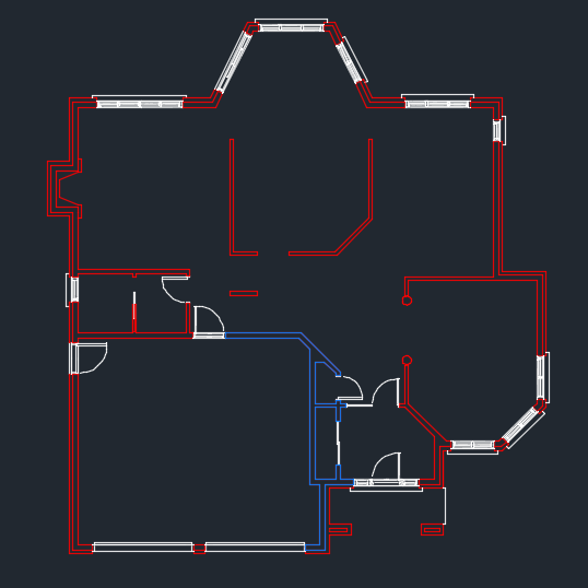

  10. Zoom out until you see all the wall lines again, then repeat the Bpoly command.
    This time, AutoCAD creates a polyline.
  11. Use Bpoly to create polylines from all the walls in the drawing file. Don't forget the small dividers between the windows.
    If you see a warning that says “Valid Hatch Boundary not found,” zoom out so all the wall lines are visible in the viewport, and then use the Bpoly command again.
  12. Press to end polyline creation.
    Note: The new polylines should have the blue color of the 3DWalls layer.
