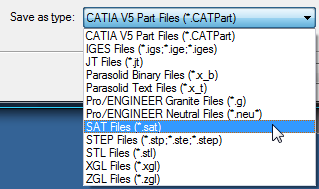

  3. From the Application menu, choose Export CAD Format.
    Inventor opens a Save Copy As dialog.
  4. From the Save As Type drop-down list, choose “SAT Files (*.sat).” Change the file name to my_blade_clamp.sat, and then click Save.
    Inventor saves my_blade_clamp.sat in the same folder as blade_clamp.ipt.
